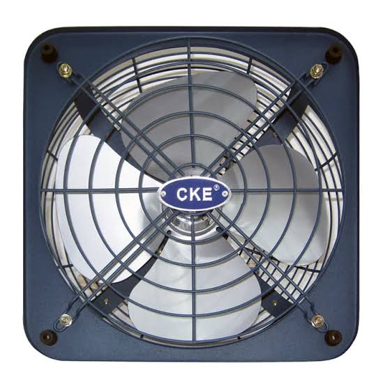

mending cool gear masih ada kata2 cool. gmn kalo CKE? :big_biglaugh:
