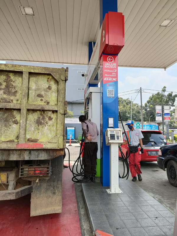

Posts: 12742
Masih ngomongin biosol?
Masa kalah sama truck kebersihan :big_biglaugh:
DEX full tank :big_exellent:
