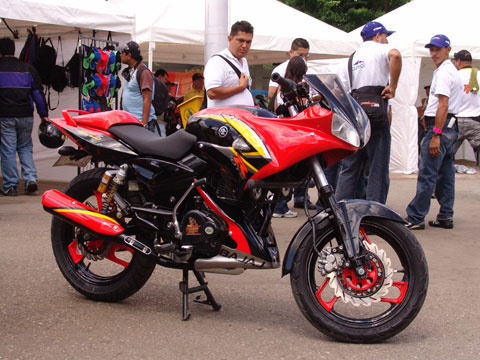

Cuma mo Sharing aja nihh.......
4'th National Pulsar Owner's Meet in Colombia
Any comments?
