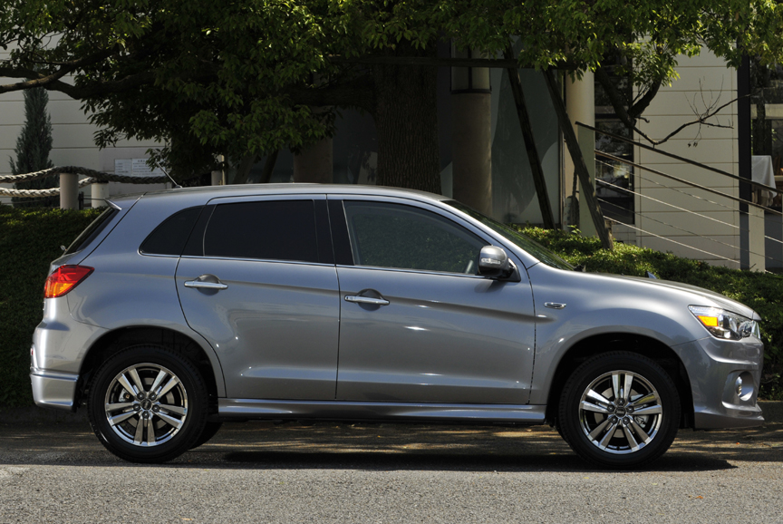

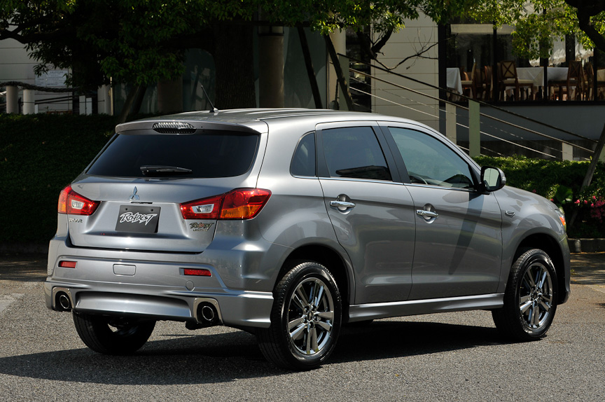

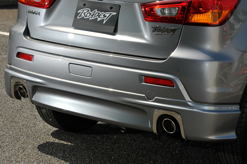

Re: Mitsubishi Outlander Sport 2012 - PART 03
Post by DigitALL »
Di Japan ada versi ROADEST, bisa jadi referensi utk modif Outlander Sport :frm_tumbleft:
denny3ck
Posts: 412
Joined: Tue Nov 06, 2012 6:45
Daily Vehicle: Outlander Sport PX
Post by denny3ck »
Keren banget......Naksir abisss..... :off_good_job:
